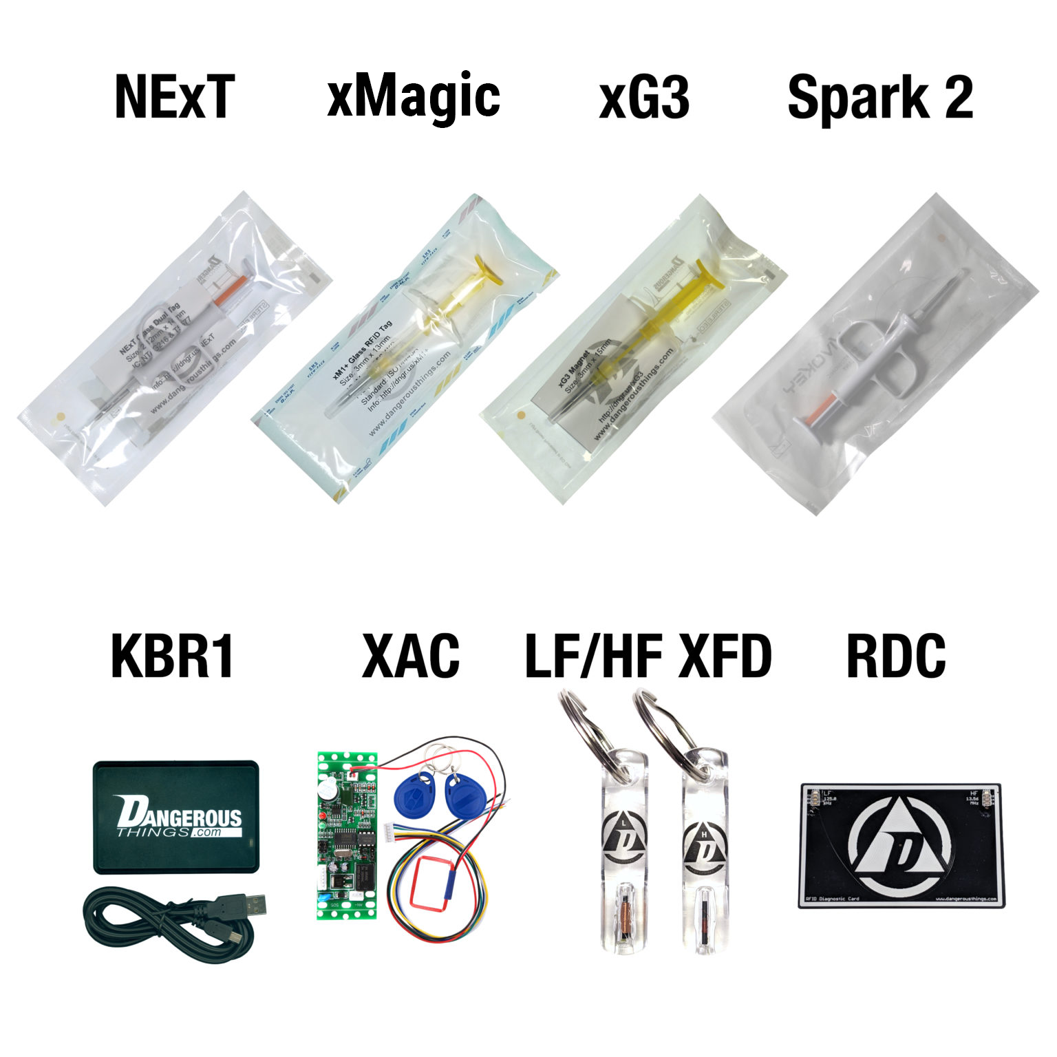

Lifestyle Bundle
*1 sterile injector assembly, pre-loaded with a NExT dual chip implant
*1 sterile injector assembly, pre-loaded with an xM1 chip implant
*1 sterile injector assembly, pre-loaded with a VivoKey Spark 2 chip implant
4 sterile gauze pads for post-injection wound care
4 sterile expandable-fabric adhesive bandage
4 pair of non-sterile, non-latex procedure gloves
*All implants are tested for function before loading into the injector assemblies, and the whole injector assembly with chip inside is EO gas sterilized.
NExT Chip Implant
The NExT is a 2mm x 14mm cylindrical chip implant encapsulated with robust Schott 8625 biocomaptible soda-lime glass. The NExT includes two chip types inside a single implant! It contains both a 13.56MHz NTAG216 NFC chip and a 125kHz T5577 RFID chip. The NTAG216 NFC chip inside the NExT works with NFC capable smartphones, certain commercial access control systems and door locks, and USB contactless ISO14443A readers. The T5577 RFID chip inside the NExT is a 125kHz emulator that can be programmed to behave like many different types of common 125kHz low frequency chips, including EM41xx, EM4200, HID 1326 ProxCard II, HID 1346 ProxCard III, Indala (and more!) access cards and keyfobs. Check out our video explaining how the T5577 works.
xM1 Chip Implant
The xM1 is a 3mm x 13mm cylindrical chip implant encapsulated with robust Schott 8625 biocomaptible soda-lime glass. It has a gen1 “Magic” Chinese backdoor Mifare 1k Classic emulator chip inside which can be programmed to behave exactly like any Mifare S50 1k Classic chip based access card or keyfob. While these types of RFID chips are considered “legacy”, there are many systems in use today that still use Mifare S50 1k Classic chips.
xG3 Implant v2
The xG3 v2 injectable biomagnet is a world first, three times! First, we solve the lifespan and robustness problems of other encapsulation techniques (silicone, parylene, etc.) by using tried and true Schott 8625 bioglass. Second, it is the only injectable biomagnet in the world that comes pre-loaded in an injection assembly. Third, it is the only biomagnet in the world that is put through a clinically sterile EO gas process! The xG3 v2 has been designed from the ground up for direct and permanent in vivo use. Using 3 special processes – a specialized magnet production process, a precisely controlled glass encapsulation process, and a customized EO gas sterilization process, we are able to make the xG3 v2 biomagnet with the same safe Schott 8625 bioglass coating the rest of our x-series implants use, and sterilize them, all without impacting the magnetic field strength. The xG3 v2 is diametrically magnetized, which provides strong lifting capabilities.
Magnetic viewing film now included!
Spark 2 Chip Implant
The VivoKey Spark 2 is a 2mm x 14mm cylindrical chip implant encapsulated with robust Schott 8625 biocomaptible soda-lime glass. The Spark 2 is a product designed and manufactured by VivoKey Technologies, makers of the only cryptobionic implants capable of performing strong cryptographic functions in vivo. The Spark is a 13.56MHz ISO14443A and NFC Type 4 compliant, readable by all NFC reader devices including all NFC capable smartphones and USB readers that are capable of reading ISO14443A chips. The Spark is plug and play! There is nothing to program, and it is cryptographically secure. It works with the VivoKey app to configure scan behavior and expand your capabilities.
Unlike other NFC implants, the VivoKey Spark 2 is not a simple NFC chip, it is a secure link to the future. With the Spark, you aren’t just upgrading yourself, you are becoming part of the most advanced cryptobionic community in the world and your new digital capabilities will keep expanding as the VivoKey platform grows. Welcome to the future.
Check here for more information on the Spark 2 and how it fits into the VivoKey ecosystem.
Bundle Extras
This bundle includes some additional goodies!
xEM Access Controller
KBR1 Wedge Keyboard Reader
The xEM Access Controller works with the T5577 chip in the NExT implant (programmed in EM mode only) and enables you to quickly build a simple access control project to open your room, house, or garage door with a wave of your hand.. or with a little more tinkering, unlock your car or even start your motorcycle ! Also included in this bundle is our KBR1 keyboard wedge reader , which acts as a USB keyboard that “types out” the UID or “serial number” of both the xM1 “magic” Mifare 1k chip or the NTAG216 chip inside the NExT implant, enabling a simple computer logon solution .
Field Detection Accessories
It can be tricky getting used to using your new upgrades. The small size and cylindrical antenna shape of these types of chip implants means getting them to read with standard readers or smartphones with NFC can take some getting used to. To help you discover the best way to get a read with whatever reader you’re trying to use your new implant with, every bundle comes with a collection of field detection accessories.
125kHz X Field Detector
13.56MHz X Field Detector
RFID Diagnostic Card
The X Field Detectors (XFD) are designed to operate just like chip implants, only instead of a chip they have an LED inside which will light up when you have found the correct location and orientation in which to present your chip implant to the reader. The RFID Diagnostic Card is a handy tool to keep in a wallet, and will tell you all about the frequency and duty cycles any readers you encounter in the wild.
