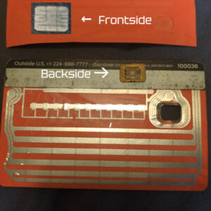

CoM (Coil on Module)
In recent years a new type of tap-to-pay module has become quite common due to a decrease in manufacturing costs. Fortunately for you, we’ve found a way to exploit it. This allows us to convert cards you may already have in your wallet! Unlike our other conversions, this one is too large to be installed with our 4g needle–you’ll need to find an installer capable of doing advanced procedures.
Take a close look at the chip in your cards for this:
This module is not directly wired to the card’s antenna as has been the manufacturing method before. If you don’t see a feature like those above, put a bright light behind the chip and check for wires connecting to it. If you see them, it’s definitely not a CoM.
Still not sure? Snap some pictures and head over to the forum.
