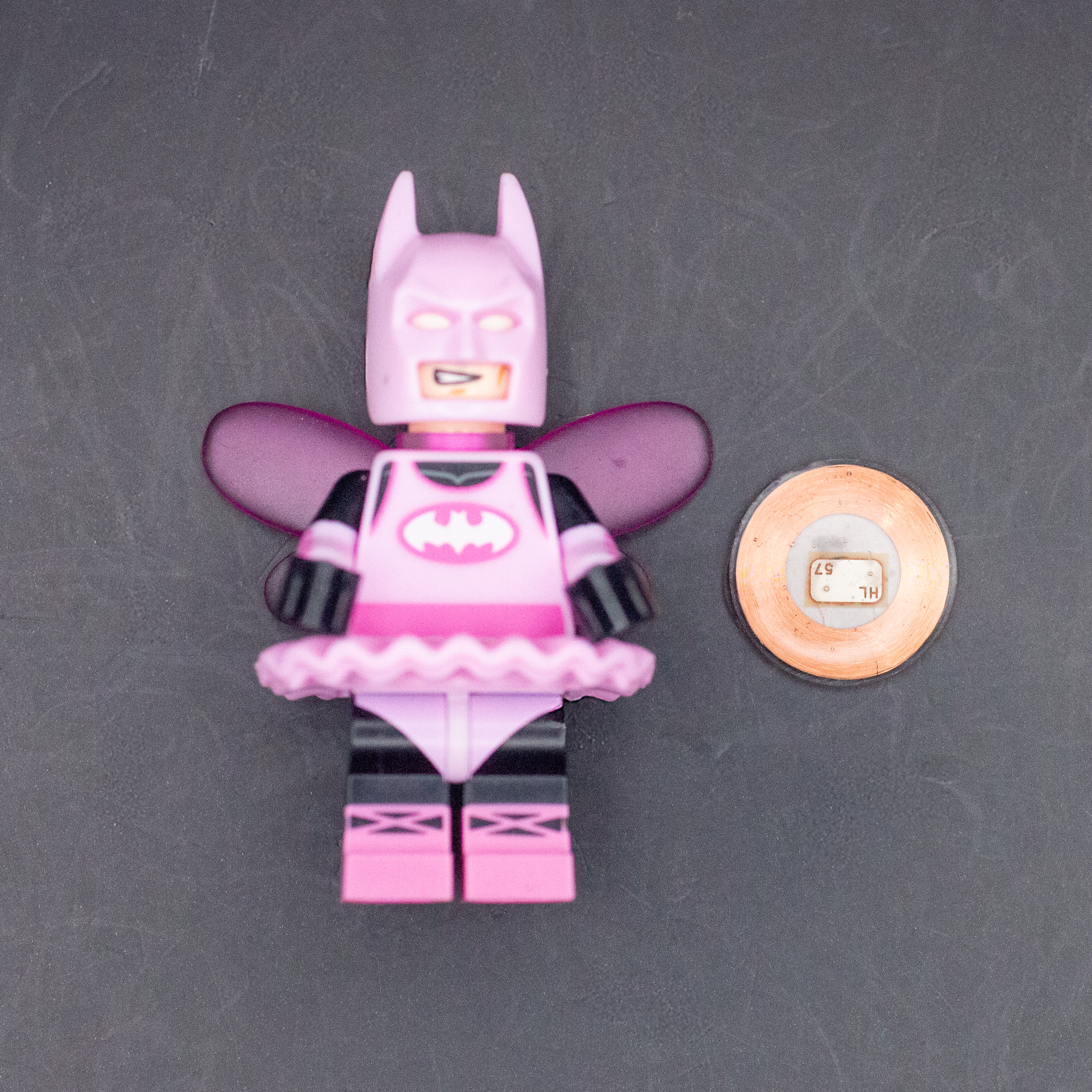

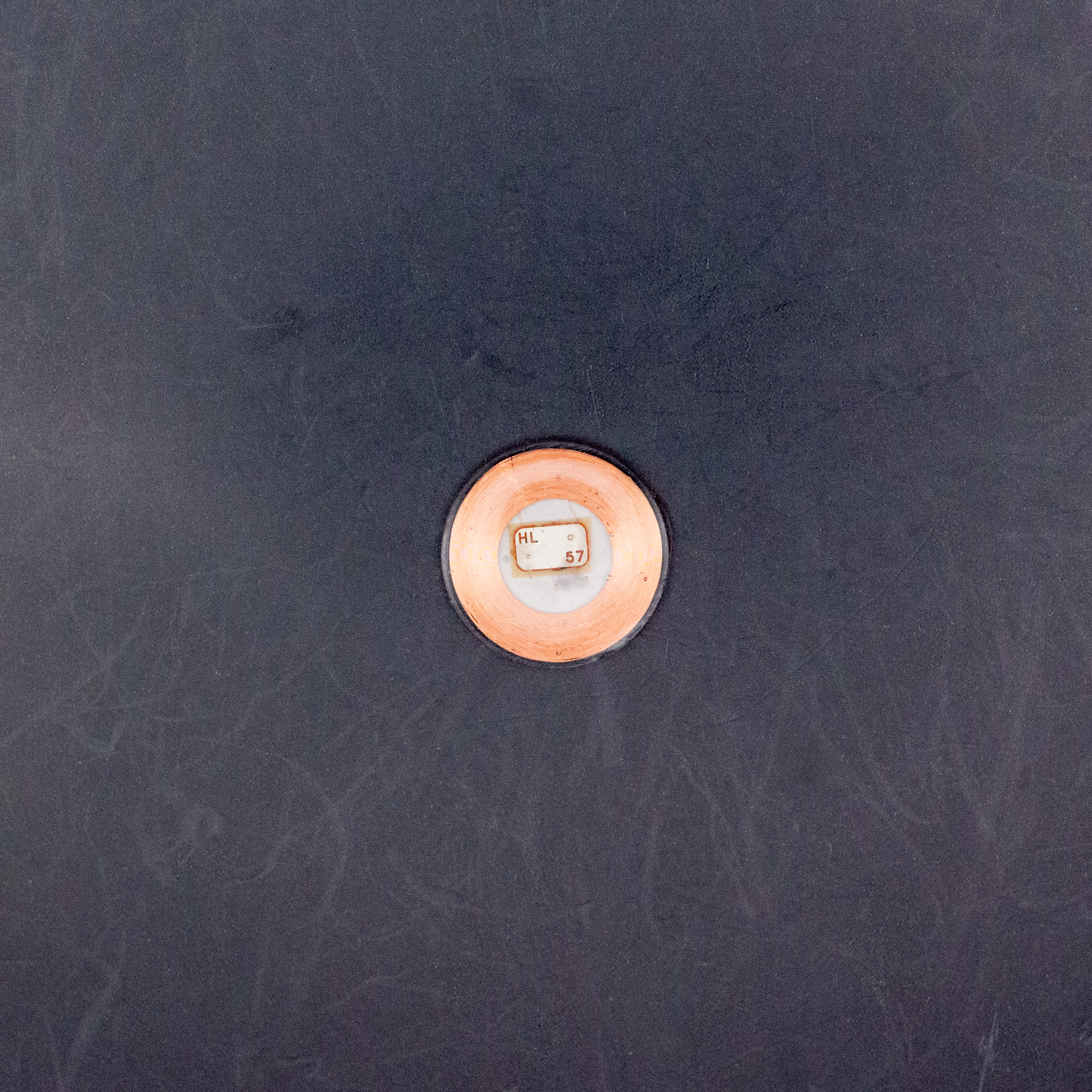

dT5 T5577
- T5577 125kHz chip emulation and cloning features
- Works with many 125kHz RFID readers
- 18mm diameter x 2.3mm thick

The dT5 is one of our next generation, high performance, 125kHz RFID transponders with a T5577 chip inside. The T5577 is an emulator that can behave like many different common low frequency chip types, including EM41xx, EM4200, HID 1326 ProxCard II, HID 1346 ProxCard III, Indala, Pyramid, Viking, AMV, Presco (and more) access cards and keyfobs. It is compatible with many inexpensive but plentiful OEM and commercial low frequency RFID readers and stand-alone access controllers like our xEM Access Controller.
The dT5 is coated in USP Class VI, ISO 10993 tested bioresin which gives it a thin profile and rigid structure suitable for installation just about anywhere. They are packaged in a gas plasma sterilized tyvek sterilization pouch that contains the flex implant which is then packaged inside a sealed polymer bag.
The performance and range of the dT5 (or now discontinued flexEM) vs the xEM is significant.

- Side with chip visible should be facing up. Do not place silver backed side up.
