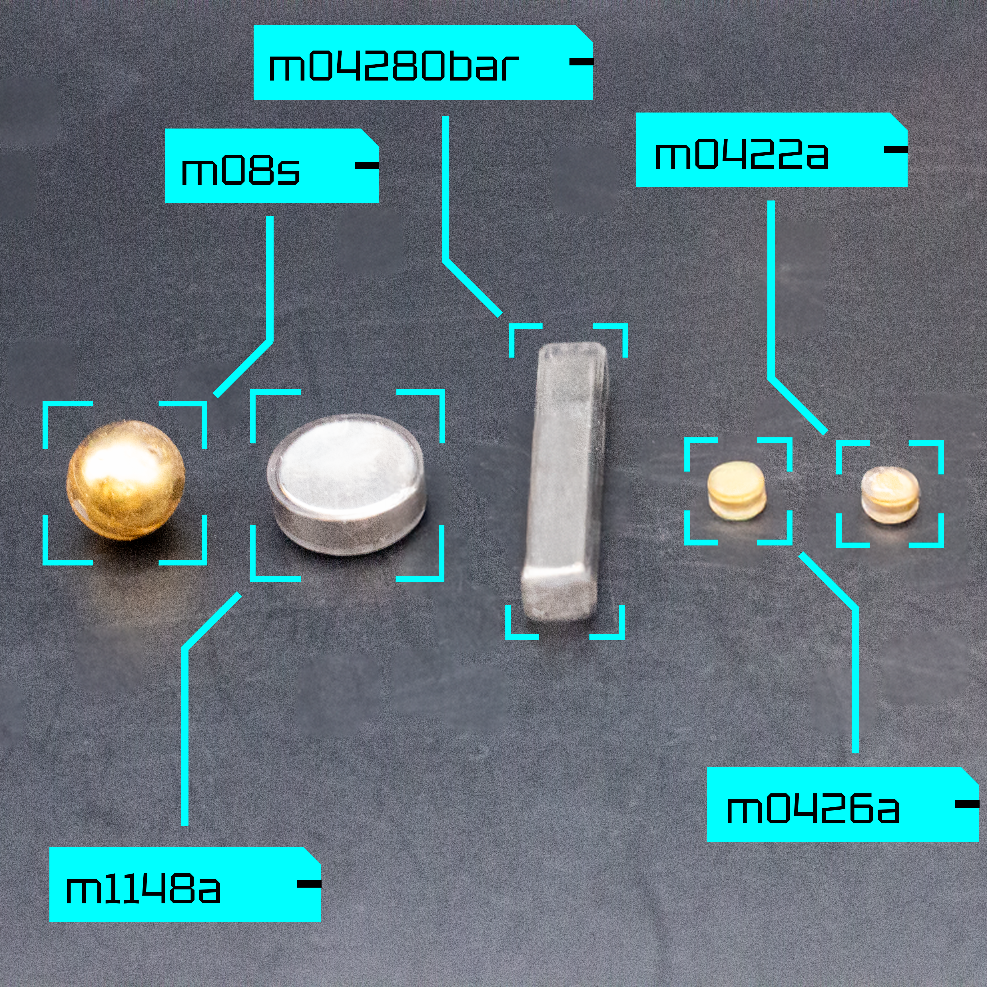

Current Offerings:
m0422a: 4mm x 2.2mm resin encased, axially magnetized, 3mm x 1.5mm n55 neodymium magnet
m0426a: 4mm x 2.6mm resin encased, axially magnetized, 3mm x 2mm n52 neodymium magnet

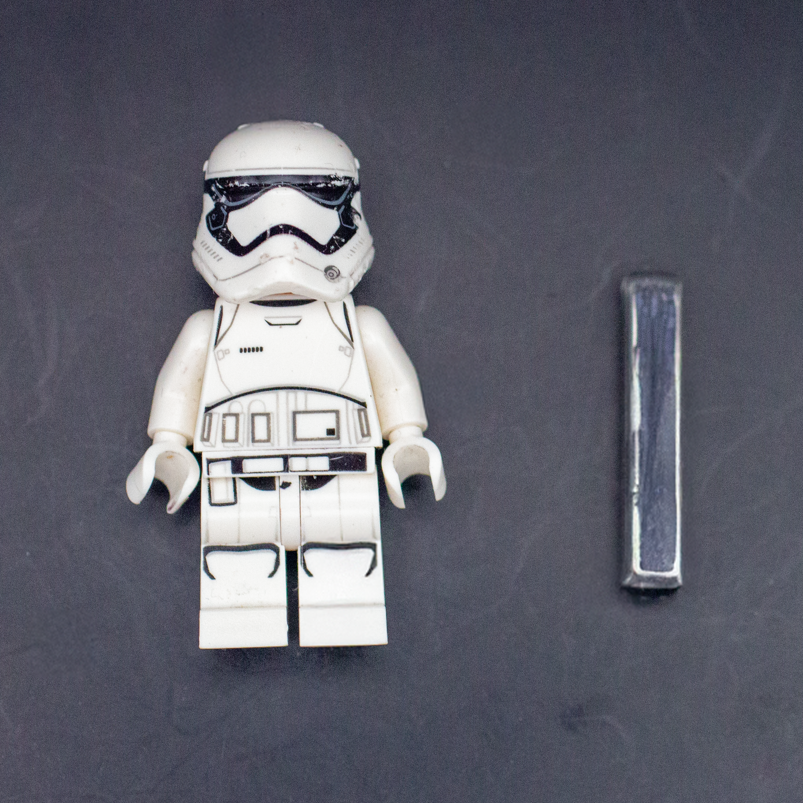

m04280bar: 4mm x 28mm resin encased, diametrically magnetized, 3mm x 4mm x 28mm n52 neodymium magnet w/4g needle
m08s: 8mm resin encased, 6mm spherical n52 neodymium magnet
m1148a: 11mm x 4.8mm resin encased, axially magnetized, 10mm x 3mm n52 neodymium magnet

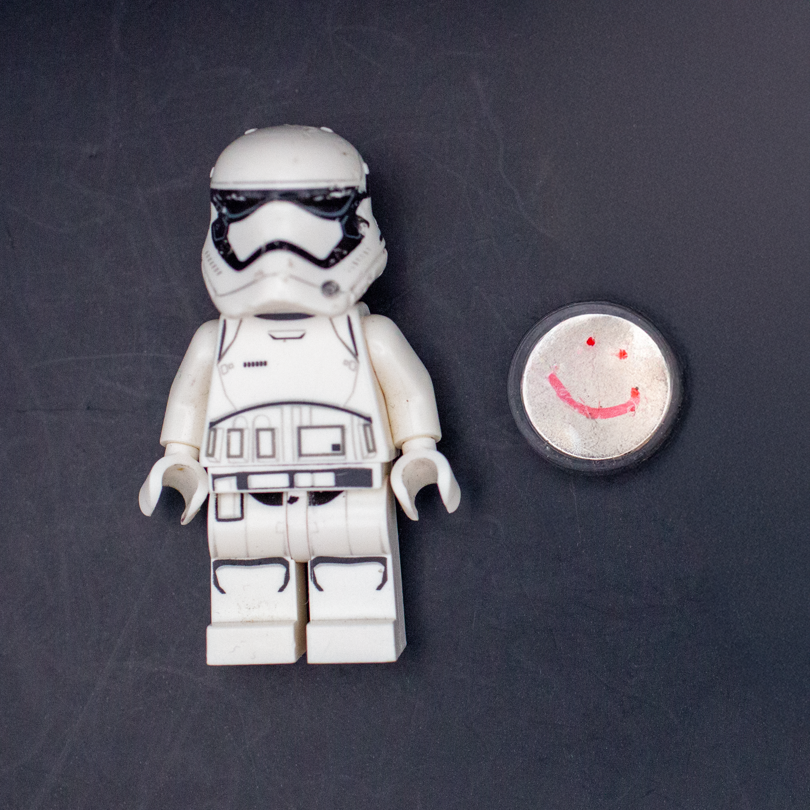

m1448a: 14mm x 4.8mm resin encased, axially magnetized, 13mm x 3mm n55 neodymium magnet. Smiley face marks the north pole. Warning: this is an extremely powerful magnet–careless use is high risk
