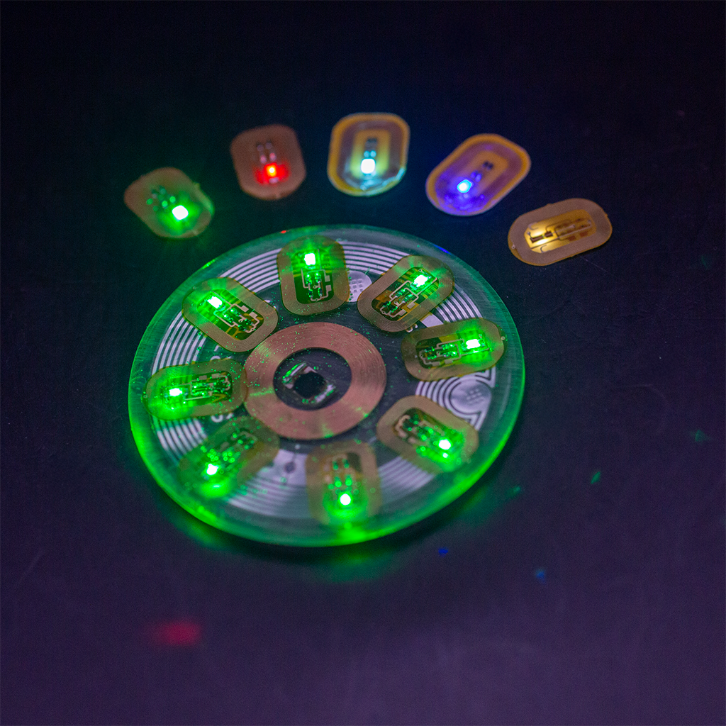

The successor to the flexNExT! Massive range for the NTAG216 and T5577! These are built to order with zero to eight LED nails. Colors available (in the order pictured from left to right): green, red, aqua, blue, and white. If you want the best performance, the LED quantity should be limited to three. When you order, let us know the colors of LEDs you want in the order you want–if any. If no notes are left, we’ll assume you want no LEDs. The price is the same regardless of LED count.

The dNExT is a jumbo-sized, bioresin version of our easily injectable 2mm diameter NExT dual frequency chip implant. It has the same NTAG216 and T5577 chips inside, only super-sized to drastically improve performance… and we can put some blinky lights on too.
