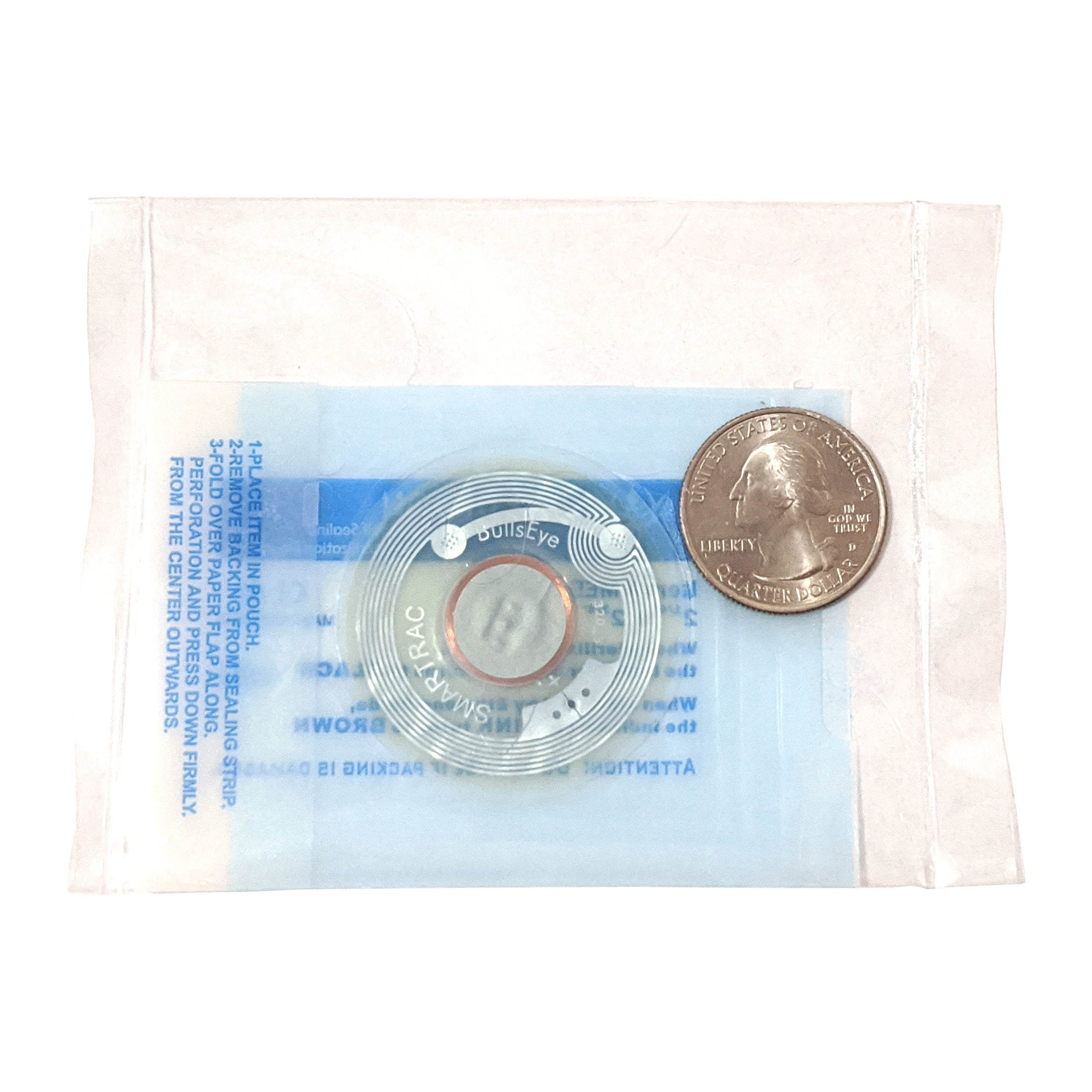

The flexNExT is a monster built for performance, and a little bit of flash ;)
- 0.4mm thin biopolymer, 41mm total diameter
- 35mm NTAG216 13.56MHz NFC Type 2 ISO 14443A inlay
- NTAG216 has 2.25" (57mm) range with ACR122U
- 15mm T5577 125kHz LF emulator chip
- 2.75" (70mm) range with T5577 and RedBee LF reader

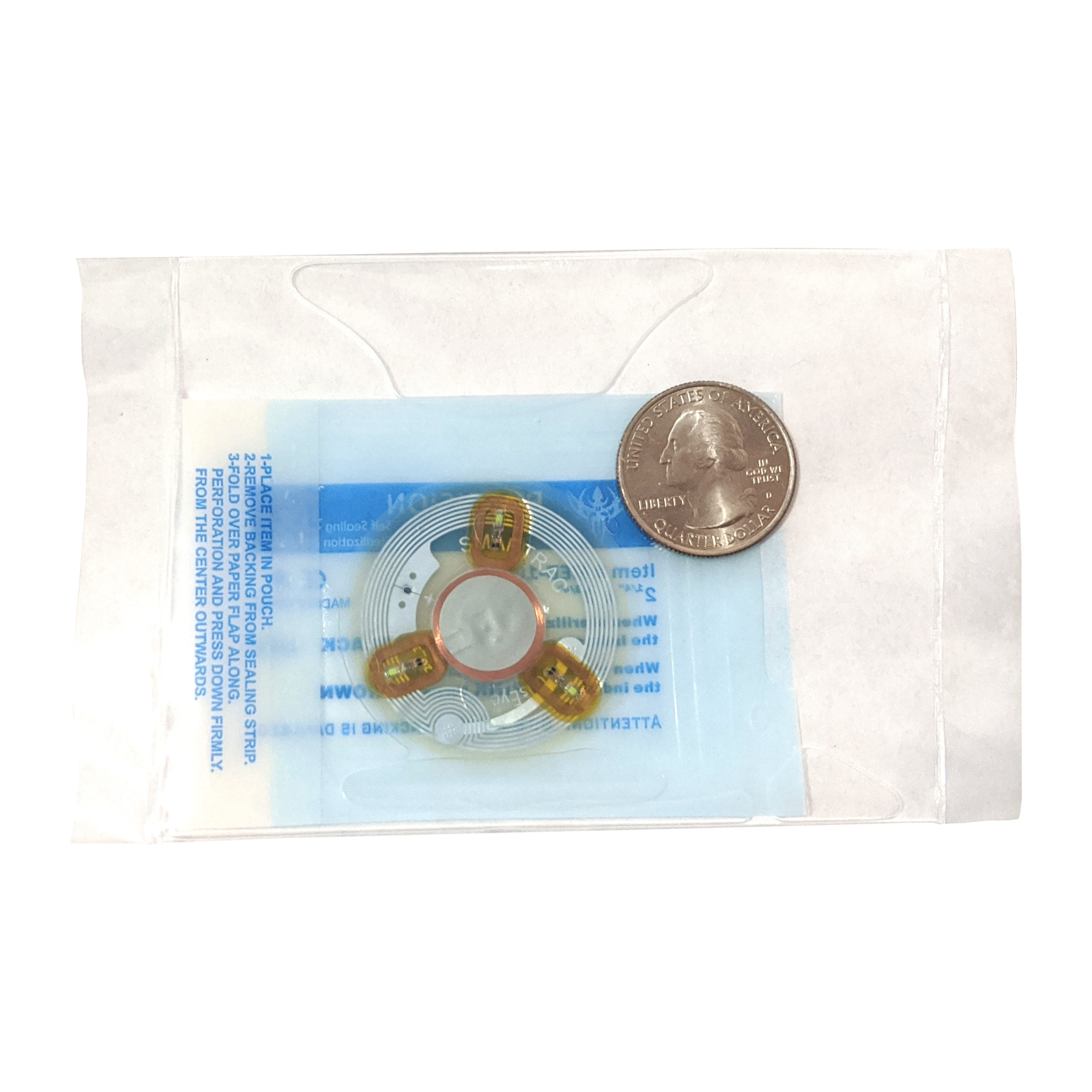

The flexNExT is a jumbo-size flex version of our injectable NExT dual-frequency chip implant. It carries the same NTAG216 (13.56 MHz NFC) and T5577 (125 kHz LF) chips, super-sized to dramatically improve performance — and there's room for blinky LED lights too.
- Share data with NFC enabled smartphones
- Trigger events on NFC devices like smartphones
- Scan to log into your computer
- Some types of access control applications
- Copy other LF chip IDs to the T5577 side
- Emulate EM41xx, EM4200, HID ProxCard II/III, Indala, and more (T5577)
- 886 bytes user memory, 7-byte UID on the NTAG216
- Optional LED indication on scan
- Dramatically improved read range over injectable x-series thanks to the large flex antennas
- Can't copy other HF chip IDs — the NTAG216 UID is set at the factory
