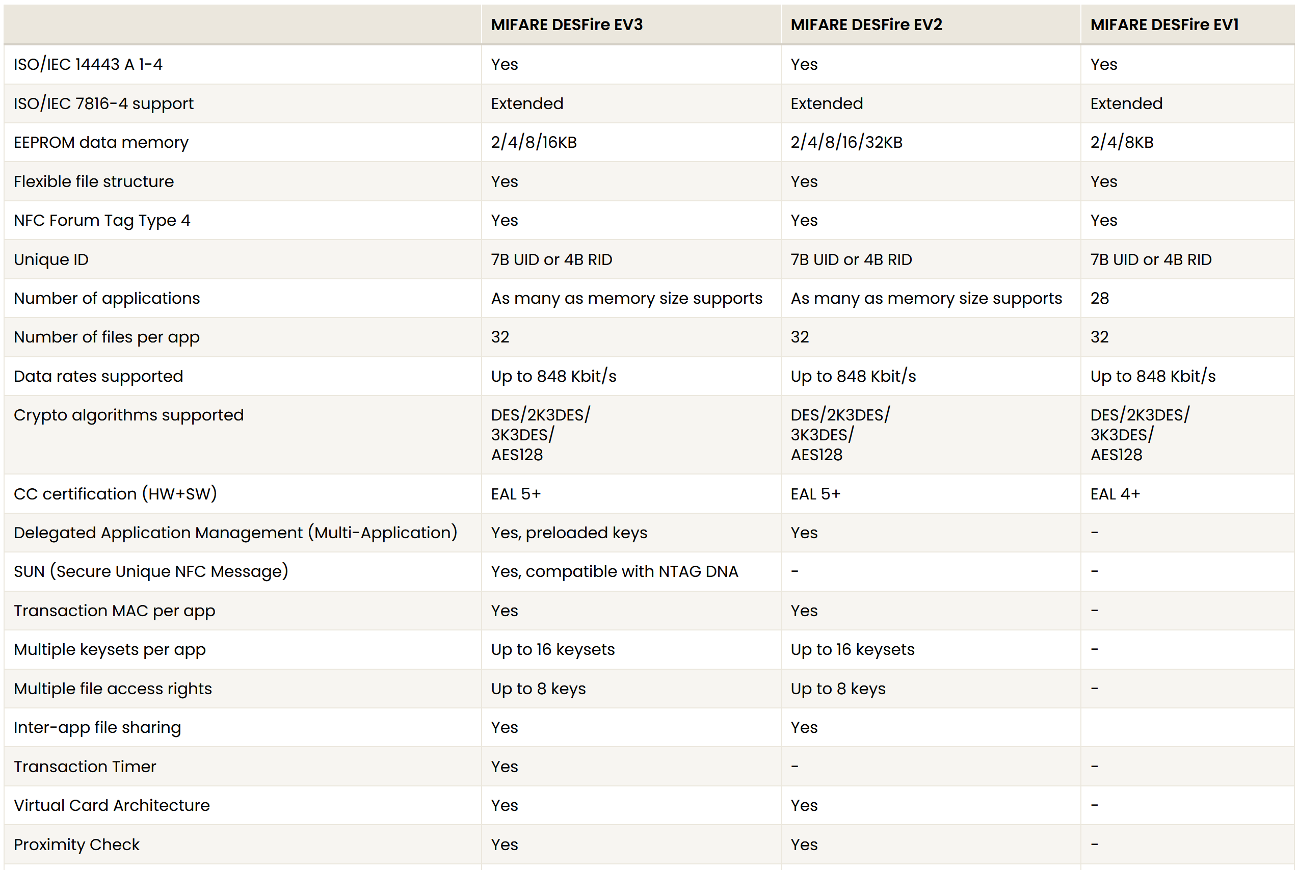

The xDF3 NFC chip implant is an ISO14443A NFC Type 4 compliant transponder. It works with NFC enabled smartphones, certain commercial access control systems, various ISO14443A compatible door locks, as well as USB contactless ISO14443A readers. The DESFire EV3 is a very powerful chip, capable of doing much more than simply holding NDEF record data for simple NFC applications. The true utility of this chip is best utilized by programmers and engineers, but there’s also nothing wrong with storing a lot of NDEF data on it either. The xDF3 has enough space you could store a vCard digital business card complete with all your contact information and even a small photo of yourself on this chip with space to spare!
The xDF3 also comes with some additional goodies, including a xFD field tester, and the RFID Diagnostic Card. The RFID Diagnostic Card is a nifty little tool you can use to easily detect what frequency and duty cycle any contactless reader is operating at. What it does not do is tell you where and how to place your xDF3 on the reader to get the best performance. That is where the xFD Field Tester comes in. Place the xFD up to a 13.56MHz reader and begin moving over the surface of the reader while trying different rotational orientations. Once the white LED inside lights up you will know that placing your xDF3 up to that reader in the same location and orientation will yield the best performance.
