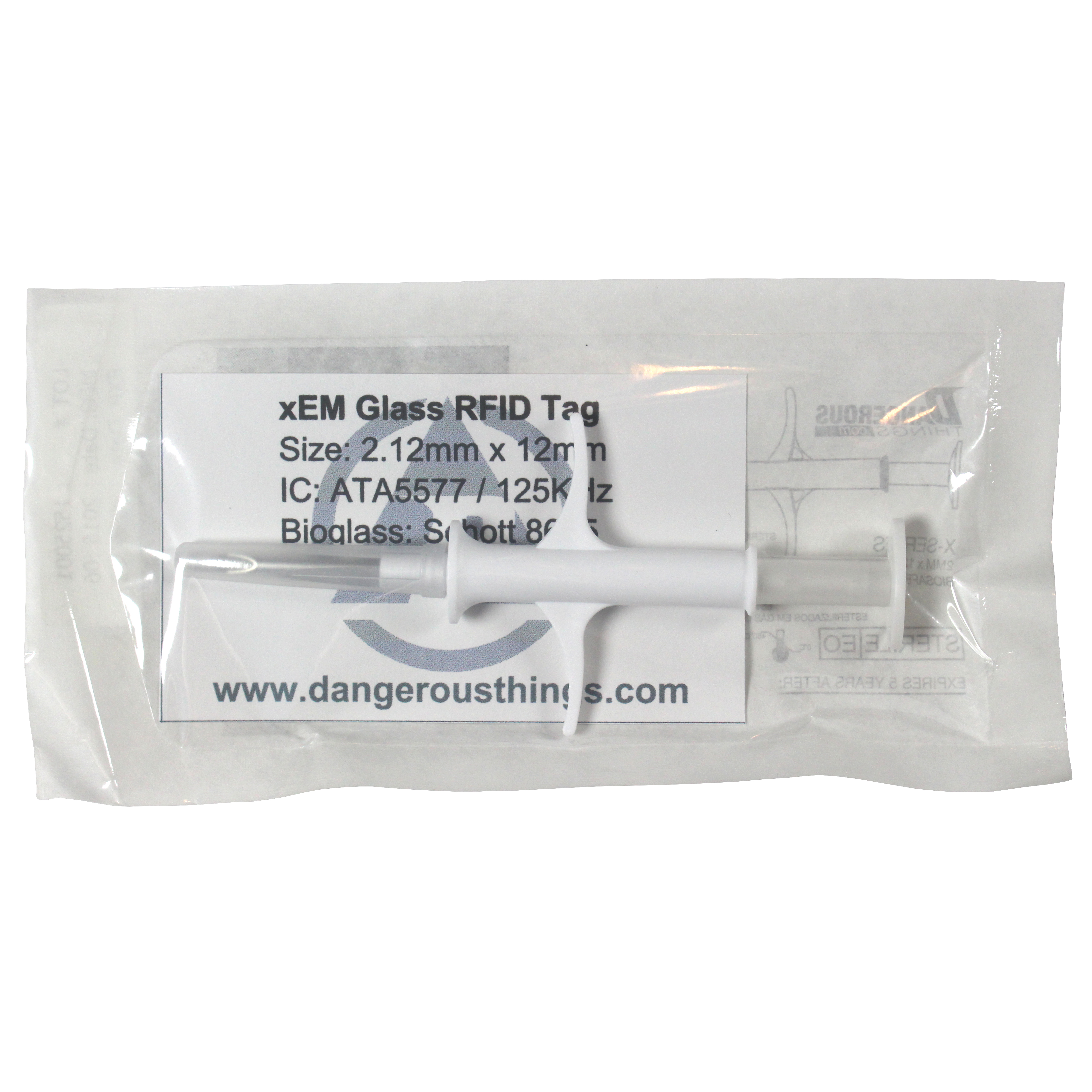

xEM RFID Chip
- 2.1x12mm bioglass encased 125kHz Atmel T5577 RFID chip
- Want an analog? Check out the STL.
- Can emulate common EM41xx, EM4200, HID, Indala (and more!) chips
- Proxmark3 can clone common 125kHz badges, fobs, cards, etc. to the xEM!
- xEM chip is preprogrammed in EM41xx mode with a 40 bit unique ID

WARNING This kit definitely contains dangerous things. While our x-series chip implants have undergone several quality checks during manufacture, and have been put through a battery of tests, they have not been certified by any government regulatory agency for implantation or use inside the human body. Use of this device is strictly at your own risk.The xEM implant contains a 125kHz T5577 RFID chip emulator that can behave like many different common low frequency chip types, including EM41xx, EM4200, HID 1326 ProxCard II, HID 1346 ProxCard III, Indala, Pyramid, Viking, AMV, Presco (and more) access cards and keyfobs. The xEM is a great introductory chip for people just getting into RFID projects. It is compatible with many inexpensive OEM and commercial low frequency RFID readers and stand-alone access controllers like our xEM Access Controller. Check out our video explaining how the T5577 works.

- 1 sterile injector assembly, pre-loaded with xEM chip implant
- 2 single use ChloraPrep antiseptic wipes
- 1 sterile gauze pad for post-installation wound care
- 1 sterile expandable-fabric adhesive bandage
- 1 pair of non-sterile, non-latex procedure gloves

Our x-series transponders are typically installed into the webbing between the metacarpal bones of the index finger and thumb, resting parallel to the index metacarpal. They should be at least 5mm away from any bone or other implants to avoid possible impacts. The reason chip implants are usually installed in the hand has to do with the extremely short read range of most small chip implants. In the case of access control where the chip must be presented dirctly to a fixed reader of some kind, the hand is easily able to be properly positoned in front of the reader. To find out more about common installation locations of the hand, visit
