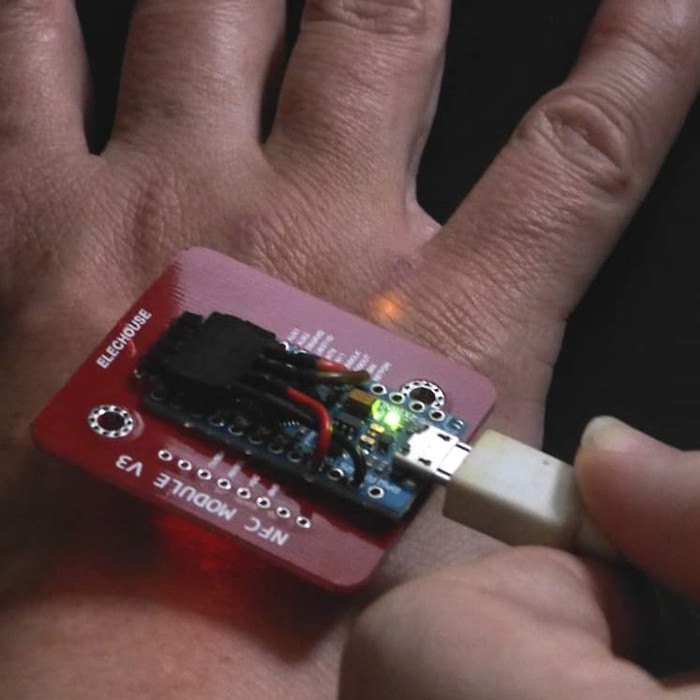

Unfortunately, most reader devices, including mobile phones, typically have antennas designed with thin PCB traces made into blocky rectangular shapes that lay along a flat plane. These antenna designs are great for coupling with and reading large flat labels and access cards which also share this antenna shape, but they have a hard time coupling to the very small cylindrical antenna coil inside our x-series chips. Most mobile phones and reader devices have a “sweet spot” or two that must be located and used each time to get consistent results. Other devices, such as the Samsung Ezon electronic deadbolt lock, sometimes use wire wound coil antenna loops inside, which work much more reliably with small glass transponders like our x-series chips. You should not expect your USB reader or mobile device to achieve the same read range with our x-series chips that you normally get with a label tag or card style tag. Here are some example videos detailing typical read performance and how to find that “sweet spot”.
The X Field Detector (XFD) can help! The XFD is a diagnostic device that mimics the x-series antenna coil winding and shows you the best possible location and rotation/orientation for holding your x-series transponder up to any reader. That’s why we include it in our deluxe bundle!
